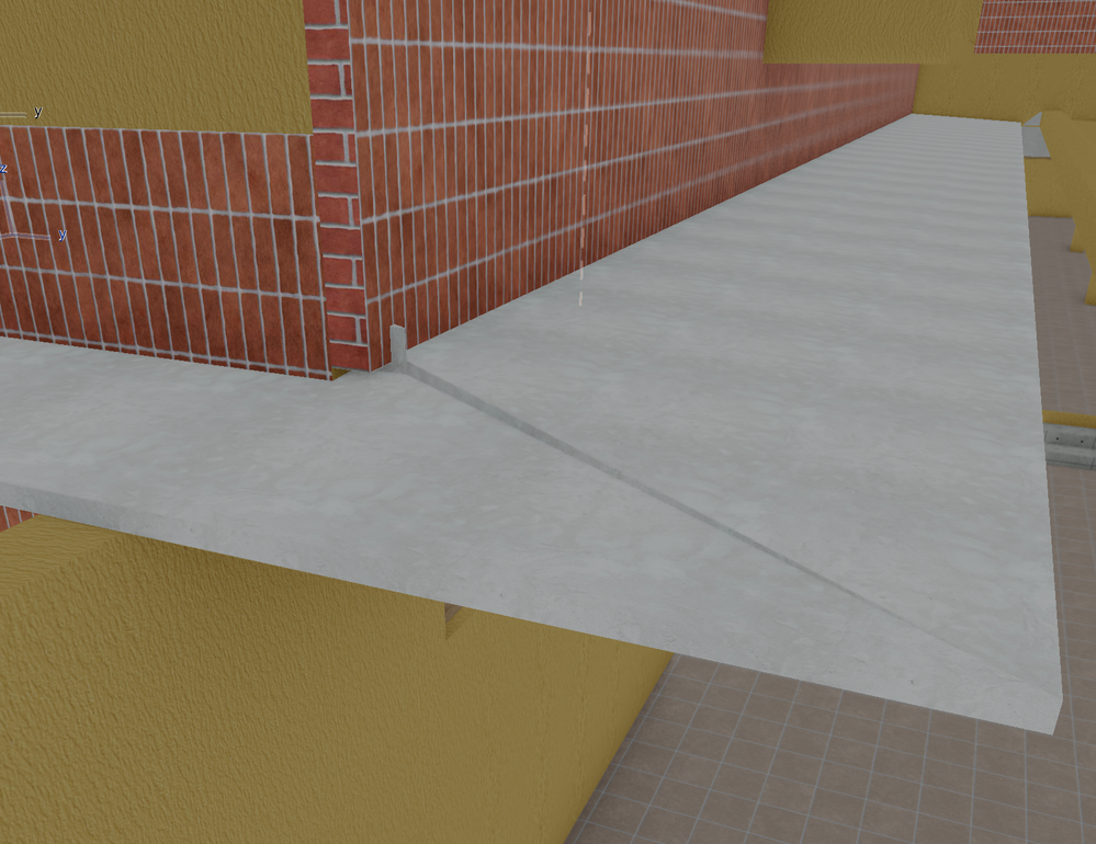

I was trying to do a sunshade with complex profile to work with beam and wall. The profle when inserted in model gives some new hotspots. The orgin seems to be shifted and when i i change the length of shade the profile moves up!.

I am not sure about the hotspots - the original bounding box before you stretch?
But the 'thickness at edge' modifier seems to be driving the bottom edge down.
And your 'beam depth' and 'WC depth' are referenced to this bottom edge, so they will move when the bottom edge moves.
That edge should be static.
The thickness at edge can be associated to the sloping surface but can be set to measure the vertical distance.
To associate to an angled edge but measure vertically ...
That partly worked but I have another problem. When i reduce length of slab, the entire slab top edge moves parallel and the thickness at the beam edge also reduces. I want to keep it same. Is it possible? When I have shade with two widths this change in angle of the top surface becomes a problem

Unfortunately it is not possible to adjust the height (position) of just one end of a line.
As you adjust the overall width, the angle of the slope and the height at the thin end will stay the same.
Or you can remove the end height modifier and the end point at the beam will stay at the same point, but the end thickness will adjust.
So there is no way you can manipulate angle of a line based on edge heights?
 Like to keep C constant and chnage A and be to manipulate that angle of line on top?

Not that I am aware of.

You can sort of control the pitch of one edge using the base Height Stretch Modifier.
In the OPs case, I would get rid of the Beam Height Modifier and turn on Height Stretch, then move the stretch stretch boundaries to only include the sloped section. If anything encroaches this space that you do not want to stretch in turn, a modifier will need to be added to it. Unsure on the interaction of modifiers outside of the stretch boundary when the cross it...
