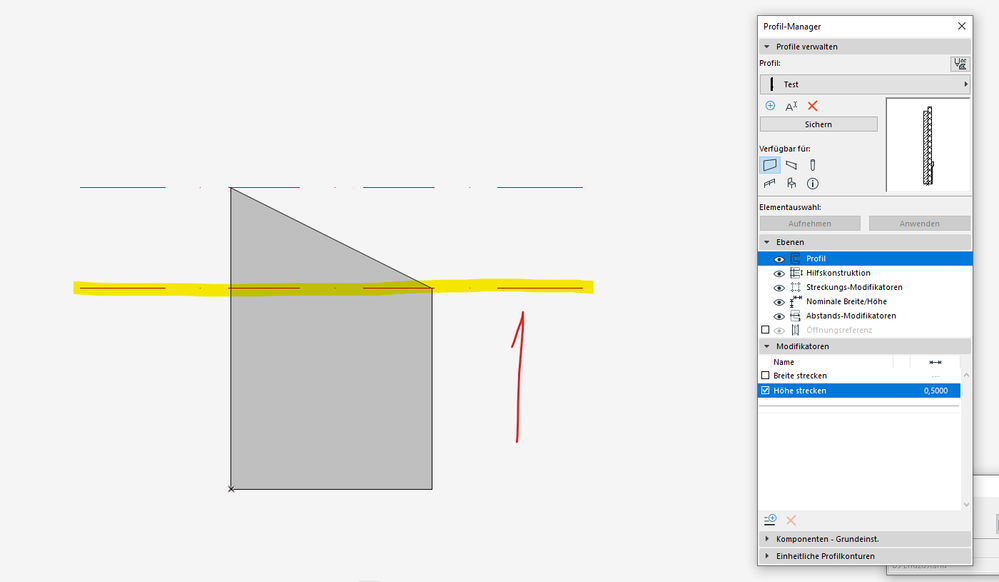

You can sort of control the pitch of one edge using the base Height Stretch Modifier.
In the OPs case, I would get rid of the Beam Height Modifier and turn on Height Stretch, then move the stretch stretch boundaries to only include the sloped section. If anything encroaches this space that you do not want to stretch in turn, a modifier will need to be added to it. Unsure on the interaction of modifiers outside of the stretch boundary when the cross it...

How is that done? can you elaborate? I am just getting a hang of it actually. Thank you!
Owais
You can follow these steps to create a dynamic complex profile:
