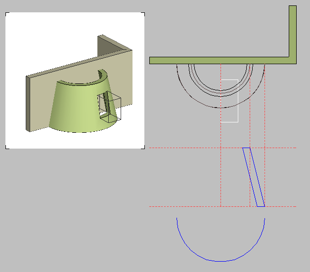

Why not use Battered Wall under Extras\Accessories\Wall Accessories\

An old school method, before there were wall extras . Just use profiler:
