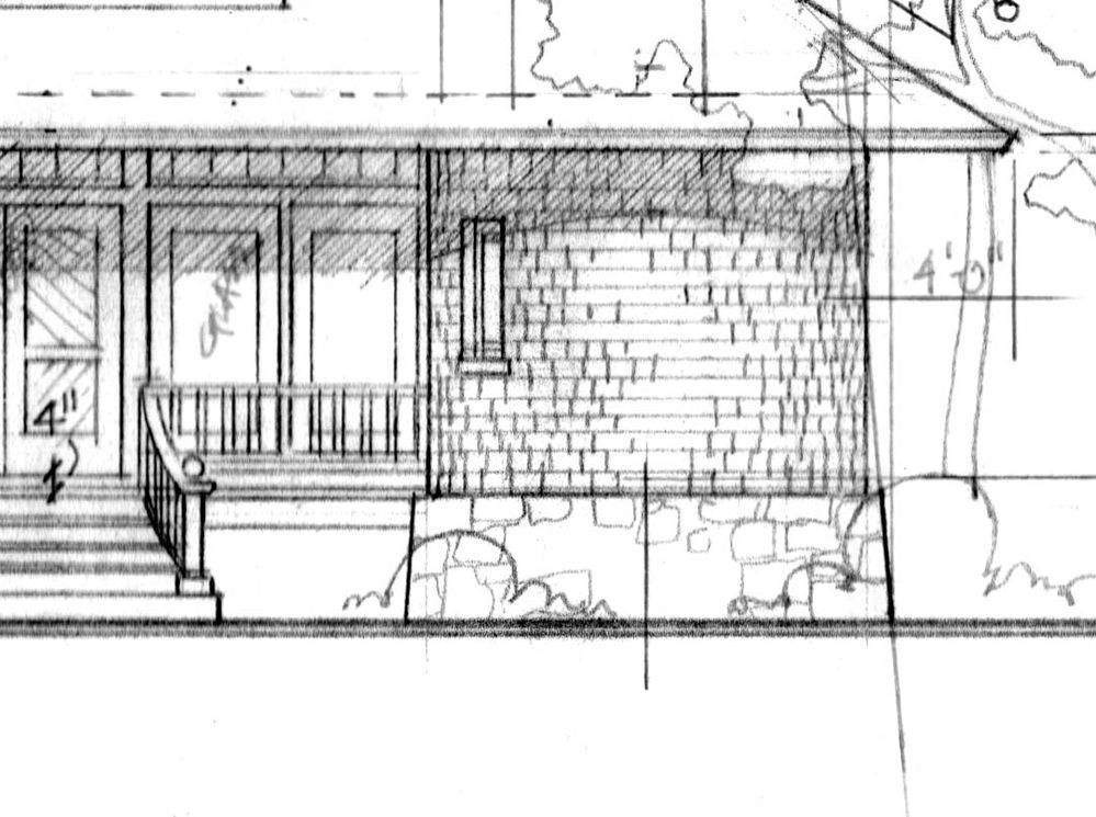

Kliment,
Good idea, here is a front elevation. The stone wall in the lower right curves to follow the round turet and slopes in from the bottom to the top
Thanks,
John
It is very simple.
First make sloped wall (roof)
And than select wall and in pop up menu you cann choose the curved wall.
Or make curved wall and cut with roof, make roof invisible.
You have used roof, so you can measure the height very well, where you want.
Now I can understand.
You can use basic element library.
And use the solid-element.
