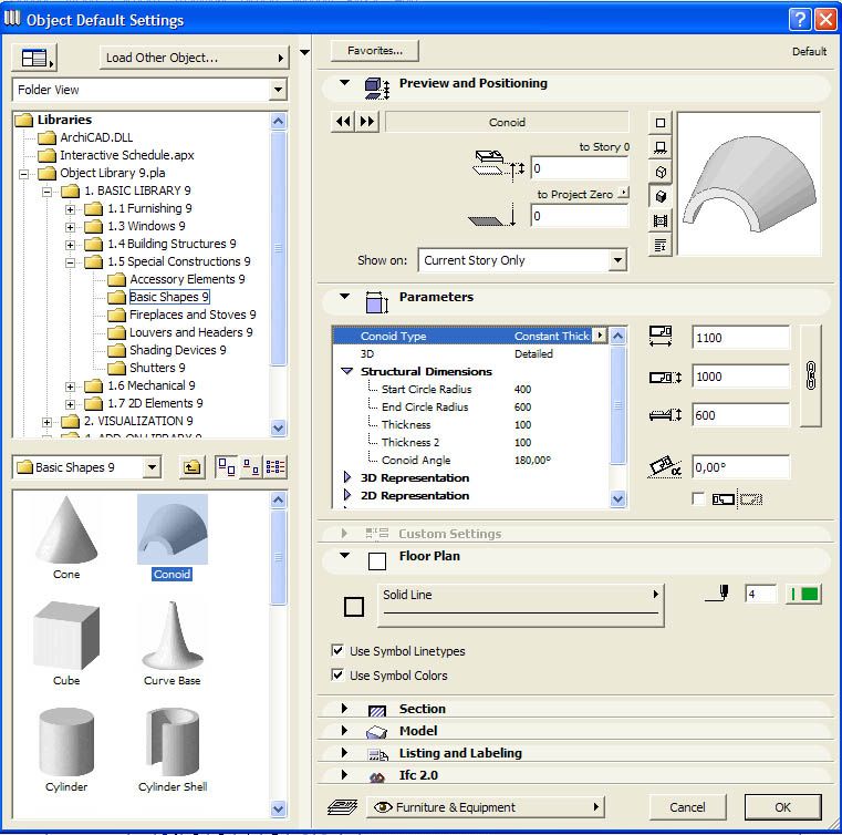

My cone object doesn't have an inside. Exactly which one are you using?
Dwight Atkinson
lagodue
Dwight declares <<My cone object doesn't have an inside. Exactly which one are you using?>>
I'm using the same one as yours - no inside. In the previous elevation drawing the stone base is shown below the first floor level and, presumably, you would not require a wall thickness to properly model this.

Dwight
referring to the original query, the issue is a tapered cone segment upward.
the conoid is horizontal.
Easy enough to fix in GDL
