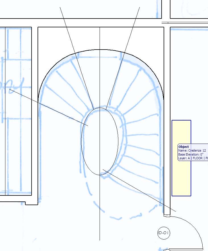

I could make it all out slabs but that would still leave me having to create an underside (maybe with objective or a ramp?) and if any dimension changes even slightly, I'd be re-building everything. It's still early in the design process so that's likely to happen.
argggg.
Any ideas how best to tacke this? any and all suggestions are appreciated!

2008-10-31 06:42 AM
Hopefully someone will come along with more info to help you.
I looked at Cadimages new 12 stair tool and it looked like they stretched out an end to stairs.
But can't recall if it would do winder and spread as yours seems to indicate.
By the way I like your concept.

Chris wrote:How do you want the underside? Is it relevant to model all of it?
I am trying to create the attached stair with little luck. The AC stair maker seems out and I'm currently working with cadimagetools stairbuilder but it doesn't allow manipulation of individual treads. I have used cigraph's archistair in the past - it allows fully custom stair/tread shapes, but I'm on v.12 now and they don't seem on top of things regarding updates.
argggg.
btw I also like the smooth flow of the stair.

Bier wrote:I checked out the video - you can modify stair runs - their perimeter shape and size, curves, etc. but you can;t modify individual treads beyond specifying some additional detail on the first tread.

Mats_Knutsson wrote:The underside will be smooth, like a ramp below the stairs. I do want to model it as I'll be presenting interior 3D views.

Djordje wrote:That's an idea - I hadn't thought of that. I guess I would have to do some back and forth between versions to make modifications, but it seems like it could work.
If you have a previous working version of ArchiStair, why not model it there and use in the new project?
Never uninstall old versions, especially if they are full of working Add Ons!😉
As it happens, I just got the cigraph dongles today so I can now upgrade and keep it all in 12. Still not thrilled with cigraphs performance the last few months, though...
