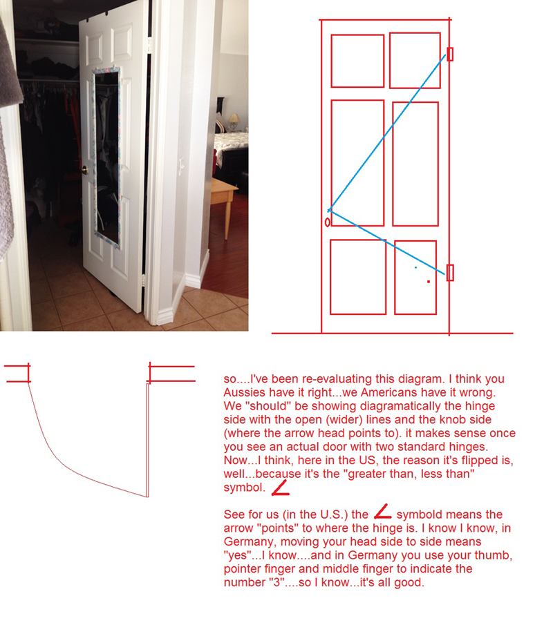

here was one other question I had.
Even in your simple example....the door you show hinged is showing the hinge on the wrong side.
the "hinge point" on ANY door is the tip of the arrow head if you will.
that's conventional drafting. you always show the hinge of the door in elevation where the two diagonal lines meet.
I know some of these doors are wonky that way where the hinge is flipped or mirrored to where it is in plan, hence you can never show the door hinge in elevation, which is at times needed.

rob2218 wrote:
Barry,
That is just the Australian drafting convention.
rob2218
really? In "down under" the hinge on the door graphics is opposite as the U.S.? cool.
Yep - seems logical to me.
