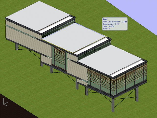

Just wondering how I can change the story level without adjusting the actual heights of whats on that level. So, in section I just want to move the story level line but keep the walls at the height they are at. Is it possible to do this without resetting the heights of all elements of that level?
One other thing. Is it possible to ghost more than one level. I have a building that is cascading down a slope with three levels but would like to show all three levels in the one plan as they are not on top of each other.
Thanks.

Situations this complex are better managed with clever layer combinations than story controls.
You might make a separate story for the roof elements.....

Yeah thats what ive ended up doing. Any idea on the changing story level height without moving the elements that are on it?

No. But the workaround would be to group everthing residing on a story so that you could adjust the "Z" in one go after changing story height...

I did try selecting the elements and setting them to a reference level
instead of the story level before resetting the story level. That seemed to work but havnt used reference levels before so dont know what the repercutions of that are. The help menu would resolve that one i guess. : )

Always think of a storey as a plan.
What would you show on one plan? All three levels, right? Then, let them all be at the same storey, and move them up and down as needed.
Then the stories above.
ALWAYS have a separate storey for the roof, foundations, site plan.
