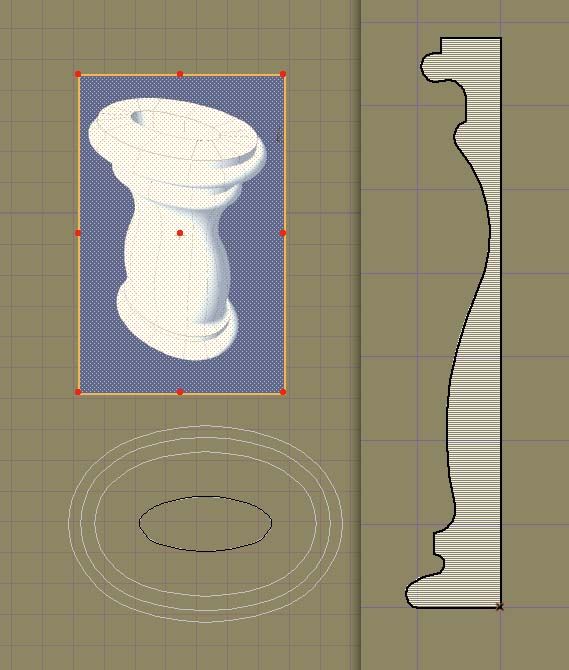

Dwight
That unreliable server delayed my example, so here is how that wall/ellipse/complex profile thingy could look
