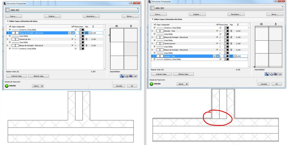

I am having an issue with PBC. Please, see attached image
I“am creating a composite.
Initially, the intersection between two walls with the newly created composite behaves as expected. But when i add a new external finish to the composites, an annoying and incorrect line apperas in the intersection.
Building material priorities are checked, and they are ok.
Neither nothing strange with layer intersection ID (by the way, both walls are in the same layer)
May be a bug?

Change the finish material Type to a finish material.
If this doesn't work (can't test at the moment) then try playing around with the strength of the external skin building material.
You may even need to create an internal skin and an external skin BM rather than just one.
There was a post a little while back (I am sure it was in this forum but I can't find it) about a bug when the BM strength was below a certain figure (around 450 I think). This caused problems with the automatic trimming.
I wish I could find the post - I know I replied to it.
I am sure it was very recent and have checked all my posts in the last 2 months but can't see it.
If I get time later I might experiment.

It could be this the post ? :
http://archicad-talk.graphisoft.com/viewtopic.php?t=51191&start=0
Francesco
exactly this is the problem. I was using Building Material with a priority higer than 545. This is exactly when the problem starts. With 546 it doesnt work.
Thank guys!
