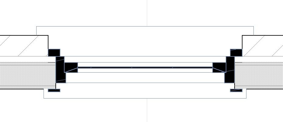

of course everything would go wrong as soon as i get the chance to go all out with archicad on a full design/construction document project...now all of the sudden my windows (on the first floor only becuase i cant place windows in a 2nd story wall) have changed to this symbol no matter what i set the fill patterns or pens to be...HELPPPPPPPPPP!!!!!!!!

Your window is set to "Projected" instead of "Symbolic." It's under the Floor Plan & Section Tab

wow...how smart i feel now....can you tell i am still learning this thing?
