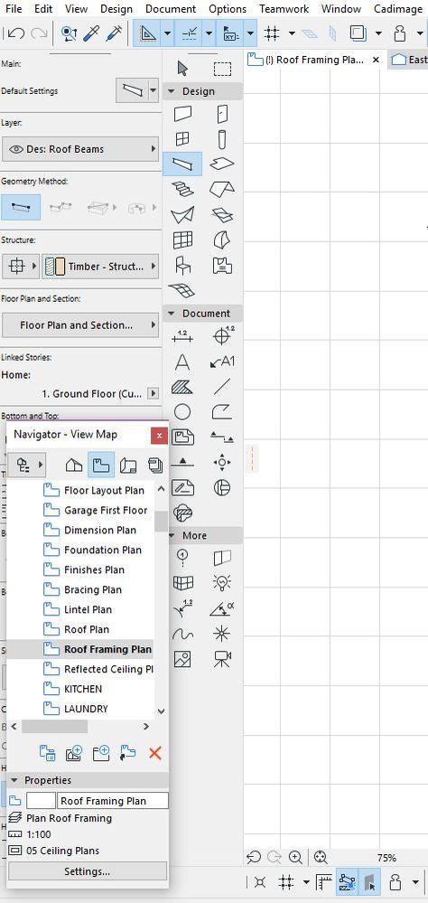

The thing that bugs me is I can't get the Navigator palette to dock the way it used to. I have always had the Info palette vertical on the left hand side, with the Navigator docked under it, each taking about half the screen height. If I needed to get to items on the Info palette I could simply scroll down. With the Navigator in the same position (see image) but not docked it covers some of the Info palette, so scrolling does not go far enough to expose the bottom of the info. And I can't seem to stretch the bottom of the Info palette when it is docked on the left to allow the Navigator to sit below it.
Also, when I drag the Navigator palette around the screen and let it go it does not drop exactly where the ghost image is - see on the image below how it is a few pixels to the right of the screen edge, when I dropped it exactly at the edge.
Is there a solution please?
Strange, I do not have any of these issues on AC20 on Windows. I can dock the Navigator under the Info Box. If I click on either of them, I can scroll them using the mouse's scroll wheel. I can even stretch them horizontally so the vertical scroll bars appear on them. Then they can be scrolled by dragging the scroll bar as well.
Finally worked it out. I had to drag the Navigator palette to the bottom edge of the Info palette, then it docked correctly. D'oh Thanks for the inspiration Laszlo
