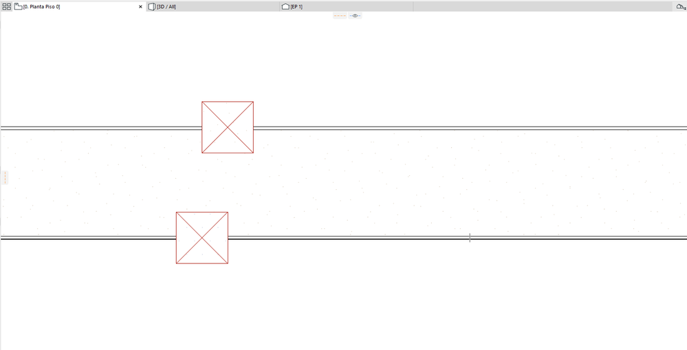

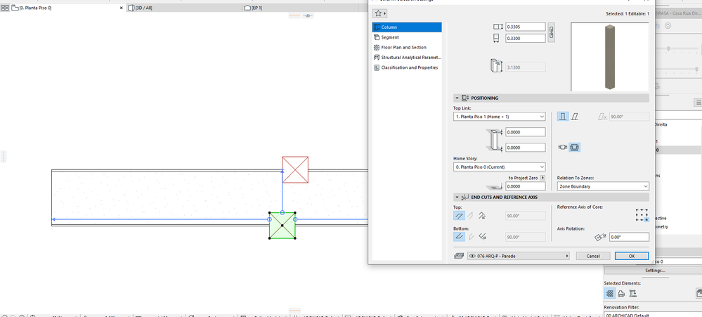

Please see this example:
I have a composite wall made of stone core and 2 plaster skins.
1. I insert a pilar made of the same material as the core (stone);
2. I choose the wrapping method required;
But the plaster wrapping around the pilar its simply not happening. Pilar and wall are in the same layer, so layer values should not be colliding, whats missing?
Thanks,
Solved! Go to Solution.

Make sure the plaster skin in the wall composite is not set as a 'core'.
Sunday
Check if View → On-Screen View Options → Clean Wall & Beam Intersections is off.

Hey vlahtinen
It was on. i turned it off and the only thing that changed was that the bottom line became thicker.
Cheers,
Monday
Monday
that was it!
Barry, ur a savior!
