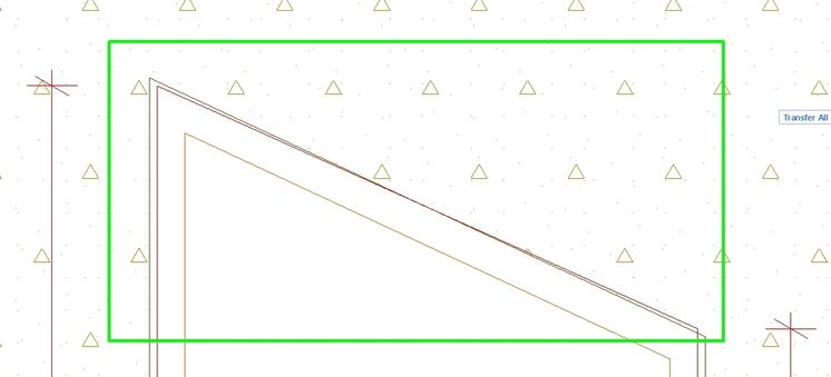

"Trapezoid window 25.gsm" window Unit dimension in conflict with Opening (Wallhole) dimension - BUG
Top part of Trapezoid window unit size is in conflict with window opening hole, hole is smaller than window both in 3D and schedules. Top window tolerance (space between window unit and window opening) is not same all the way and gets in conflict in bottom part. This object need to be fixed. Also object needs option to have different tolerances on bottom, left and right side and top.

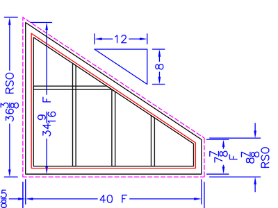

Red line showing window unit size, while black line showing opening in the wall.
We have issue in our wooden frame houses that trapezoid windows are not fitting into house frame. Windows are too big.
When tolerance switched to 0 everything is alright, but when you setting up tolerance to several mm strange opening and window size behavior in top part appears.

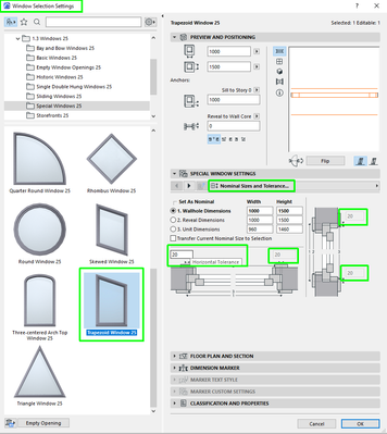

can you share a screen shot of the window settings you are referring to as "tolerance"? is this a rough opening setting?
Hi 4dProof,
Tolerance is gap between window opening (Wallhole) and window unit size arounds it perimeter. Added printscreen where this setting is ajusted.

A simple elevation drawing like the one below from our window supplier where you can set the overall height, short side height, width and slope (this way or in degrees would be an option to select) would solve this problem handily. another setting for the shim gap for each side added to that would be amazing.  This would work for any sloped window in the library.

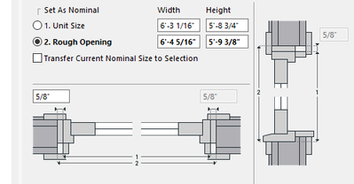

I think the primary issue (for the US version) is that Archicad always seems to assume the sill of the window is resting right on the structure.  For example we actually need a 5/8" gap all the way around the window frame to the opening.  If you put in a 5/8" gap in the window setting it puts it on the sides and the top but not the bottom.  You can even see it in the diagrams in the window settings below.  The same is true for normal windows but at least the RSO is correct because it is a rectangle but it still isn't 100% correct if you look at a section in fine detail.  This points to a fundamental misunderstanding of how windows are installed in wood frame structures on the part of Graphisoft developers.  Maybe it's different in Hungary and they actually put the window directly on the bottom frame I don't know.  I also notice that the settings in the image you shared DOES have this setting and you are still having problems so I don't know I might be wrong on this one too.  Not sure why they are different.
In any case a gap setting for the bottom that is independent from the sides and top would be good to have in the US version.  This would allow flexibility for local standard practices.

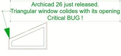

Just updating this bug.
Archicad 26. Trapezoid window still in conflict with opening - critical bug that cost money to fix in construction site, also later you need to order another window or do some other fixing in site.
