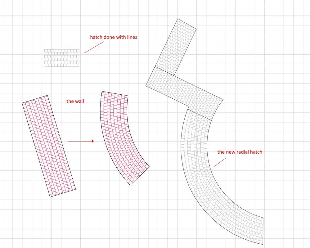

can't believe it took me years to realize that archicad actually has a way to make a proper radial fill... - very useful in many situations, for example when trying to draw radial stone paving

sounds complicated, but what this actually allows is that you make your own radial fill:
1. draw a hatch pattern yourself with lines (can be over an existing hatch that you want to make radial) and be careful that it can multiply seamlessly - then select & copy
2. go to element attributes - FILLS, make a new SYMBOL fill - paste the pattern here and be sure that the CUT fill is checked
3. go to BUILDING MATERIALS - make a new material with a this new fill as a 2D representation and as fill orientation select FIT TO SKIN
4. draw a wall with this material, make it radial and use the wall to roughly fill the area you need to be hatched
5. explode the wall(s) and adjust
(this is the way to do it with a new custom hatch - of course it's possible to use the existing symbol fills - just be sure they are cut fills)
sure it's not ideal, takes a lot of tinkering and adjusting the scale of the fills/materials but i think this is amazing...

Dear GuillaumeArchicad, you need to take closer attention to what mIrage66 wrote.
Only if you make a composite with the building material and construct the wall with composite it will distort the fill / fit it to the skin!
