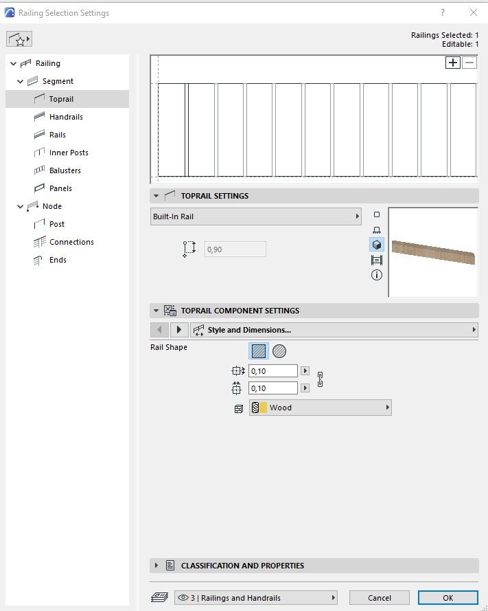

Im trying to make a railing with the railing tool, except that the top rail isnt showing in 3D or 2D. Ive tried the model filters and everything is on.
Any ideas???

felcunha
Can you show us a capture of the top railing options?
Felipe Ribeiro Cunha
AC 26, macOS Monterey
Strawbale23
Sure, Measurements are in metric. Rail top 10cm
Thanks
AC26
https://www.zendsign.fr/
felcunha
It seems you didn't add it... just click on the "+" button at the top right corner

Strawbale23
Fantastic, thank you!
