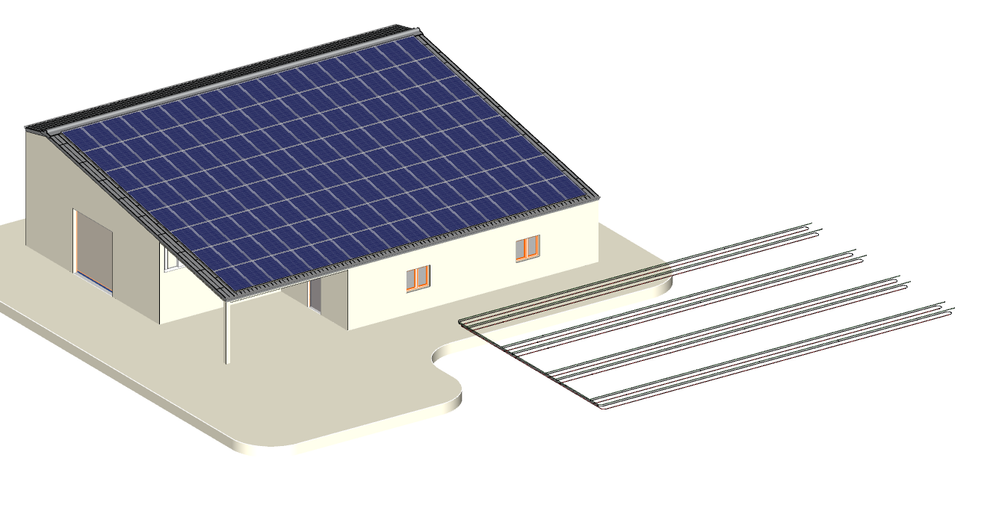

I want to create a 3d model of the electrical cabling on a PV roof.
I have created the cable run with MEP, but its horizontal, I need the cable to run at the angle of the roof. Ive attatached an image to illustrate what I mean.
Is there anyway to rotate an object in the vertical plane so that it matches the roof angle??? The cable can be seen in front of the building

1. Use Rotator.gsm........Save your cables as an object and then rotate it with rotator.gsm
2. Save your cables as object and then add rotate around x, y,z axis into the GDL code
or you can use ArchiRotate if you have ArchiSuite, it is very easy

Take a look at OBJECTiVE. It provides a tool to rotate and selection of objects about a specified axis, and can rotate in section/elevation views too. The assembly tools would allow you to toggle the cables between the finished position in the roof and a flat plan view if subsequent editing was required. It also provides a split tool that would enable you to cut your cables in plan or elevation for more complex roof layouts. The videos on the product page illustrate all these functions.
