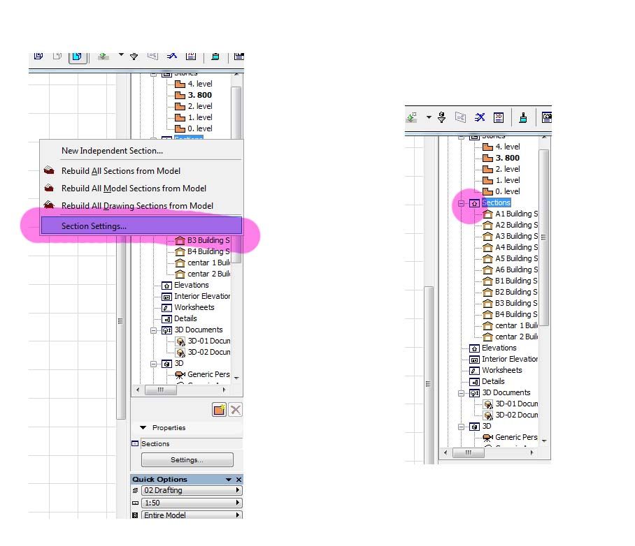

how can I modify setting of my sections all at once I try with right click on -section - and modify section setting but no thing happen to any section ?? I did not know what my wrong ...

When you right-click on the top Sections icon and select Sections Settings..., in the upper right corner of the dialog box you will see Default rather than Selected: #, so you are changing the default settings. To change the Sections' settings, select the actual Sections in the Navigator, this can be done in one step (on the Mac, there should be a similar way on the PC) by selecting the top section, hold down the Shift key, and select the bottom section. Then click on the "Settings..." button to change their attributes.

David Maudlin : thank you I was selected sections and right click I had only delete but I don't try with settings button ....thank you
