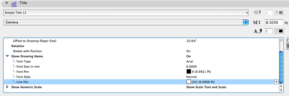

Stress Co_
If you don't want to mess with GDL...you could assign the line's pen color to one which prints the same as your background. Look under "Show Drawing Name" for the setting. Which title are you using?
A Custom title with an "omit the line" option would be better.

vfrontiers
I take it SIMPLE TITLE 11 isn't what you are looking for?
