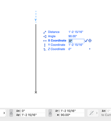

Something got bumped & my typical numerical input is all weird...
What I'm expecting: click for first point, then drag for direction per the directional snaps, then type in value for distance in that direction. [The tracker value should be the Distance]
What i'm getting: the typed valued is immediately inserted in the X Coord of the tracker box (no matter the direction i've moved in). It's exceptionally irritating!
The image below is a line created and the tracker popping up as soon as I start to type for the second point. It jumps to the X field.
How do I get back to the previous tracker behavior of highlighting the Distance box first for any typed input?

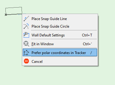

As you start to draw something, right click and choose 'Prefer polar co-ordinates in tracker'.
That will reset it to distance and angle.
