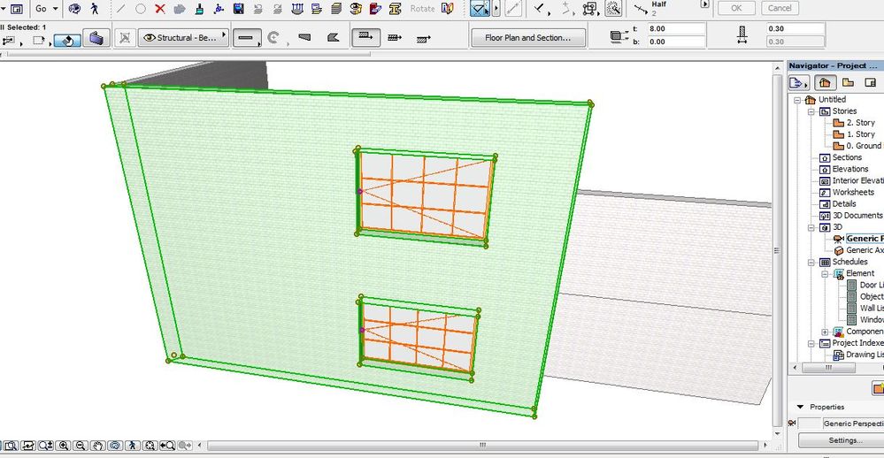

Hi i have very important maybe we need it especially after thinking in facade as one big one
my question how can i split this wall to be divide on two floors instead of one mean if it is 8 meters height while i think
i want to make it 4 and 4 for two floors after i made the facade here is the image may explain my purpose

Unfortunately you can not split the wall across stories.
You will have to modify the wall to be a one story wall.
Then you can:
  • Copy and paste from one storey to the next in plan
    Multiply the wall vertically in the 3D window
    Elevate multiple copies in the 3D window
You might want to ensure that the "Set home story by elevation" box is ticked in the multiply window to ensure the wall goes to the correct story.
