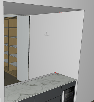

Hi there,
Ive tried to insert a window into a single skin composite but its showing up like an empty opening and not a window. When i select the window and go into properties its showing the 3d view and 2d view as a window but in floor plan and 3d its empty?

Check Your Model View Option settings for the display of windows.
This will affect what you see in the model, but not what you see in the window settings.

Hi Barry,
Thanks for getting back to me. It doesn't seem to be MVO issue as the windows on the external composite of the model are viewing correctly?
The only other thing I can think of is it has a renovation status that is currently set to 'hide'.
