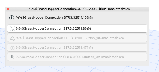

Laszlo,  I've recently downloaded a 90 day evaluation license for Rhino 7 on a Mac to see if its something I want to use going forward.  I was very excited to see the above post, but I am having trouble getting the connection to work.
This is how the add-on palette appears in ArchicadScreen Shot 2021-09-05 at 08.57.30.png
Any suggestions would be welcome.
Thanks

Hi Stuart,
Thank you very much for your question!
From my experience, this issue happens if you don't have the latest update for Archicad 24 installed, which is 6004. Could you please download and install the latest build here and let us know if it fixes the problem?
Looking forward to hearing from you!
Best regards,
Minh
