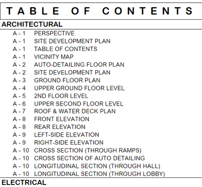

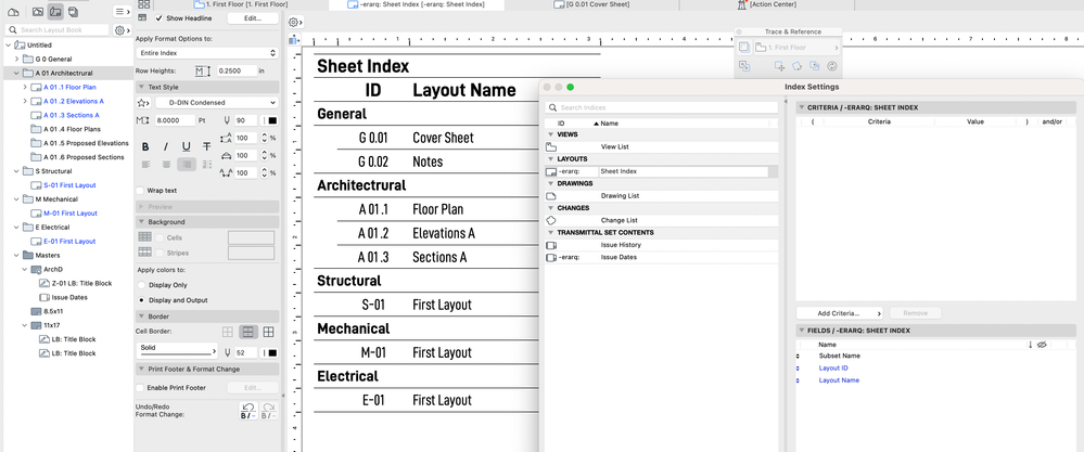

Good day! Is there a way for me to create a 2nd headline after the Subset Name like this:
Subset
>  Layout
   >> Drawing1
   >> Drawing2
   >> Drawing3
>  Layout 2
   >> Drawings in Layout 2
Subset
>  Layout
   >> Drawings in that Layout
Thanks in advance!
Phoebe

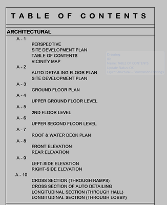

Eduardo Rolon
Like this?
If so click here

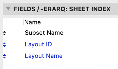

fowebe
Hi Eduardo! Thank you for your answer! However, my options look different.

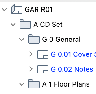

Eduardo Rolon

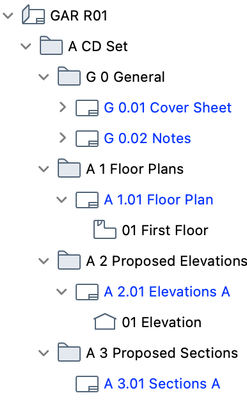

I think that what you are missing is creating Folders in Layout so that you can add "Subset Name" to the Index criteria

fowebe
Hi! I do have Subsets. Just not the option to make it a secondary headline.

Eduardo Rolon
In the Index Scheme settings you have added Subsets?
Sections and Elevations need to be in their own folders.

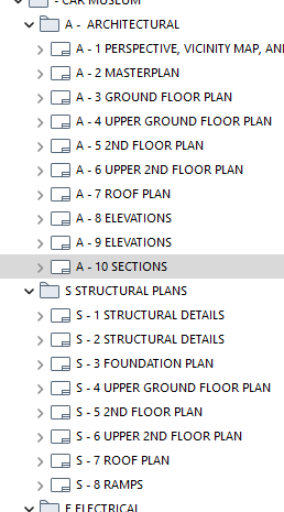

fowebe
I want the Layouts grouped in: Architectural, Structural, Electrical, etc

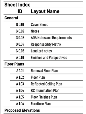

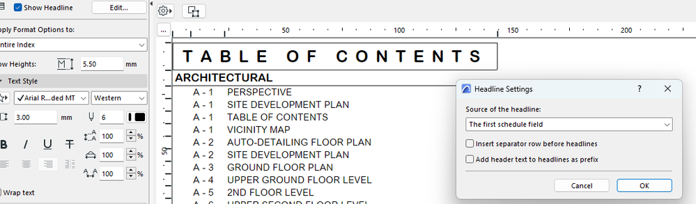

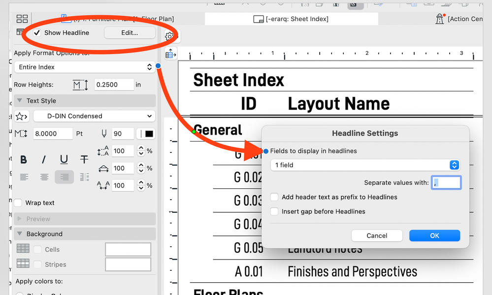

Eduardo Rolon
Ok got it, my Bad
First option, but you want and extra headline under architecture
Second Option using Custom Text to add the second Field:
Third Option for more complex projects and which is the one I prefer is to create an Index for Architecture and another for the consultants:

fowebe

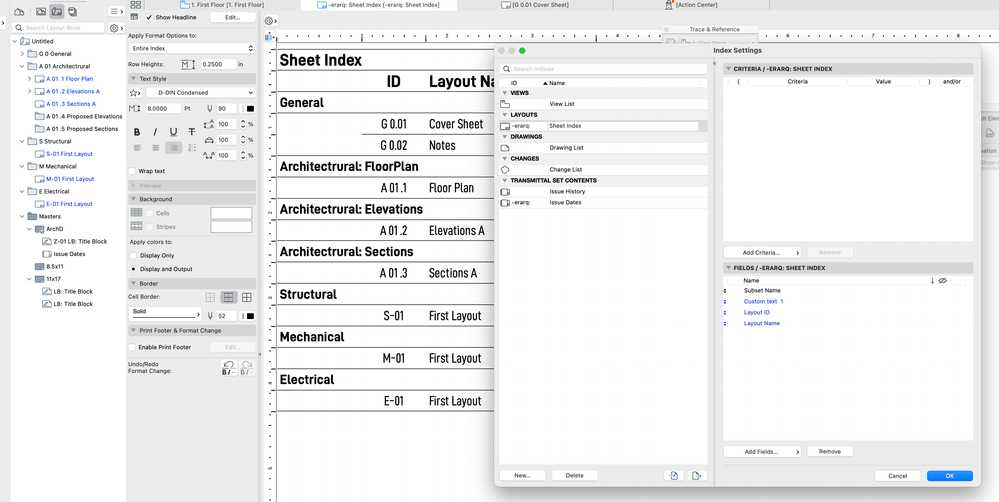

I opted for a new Custom text Column, then hide (column width = 0) the Layout IDs (can't remove then cause I need them for Arrangement) and added empty & nameless views on each Layout for Custom Rows at the top.
Thanks so much, Eduardo!!!!
