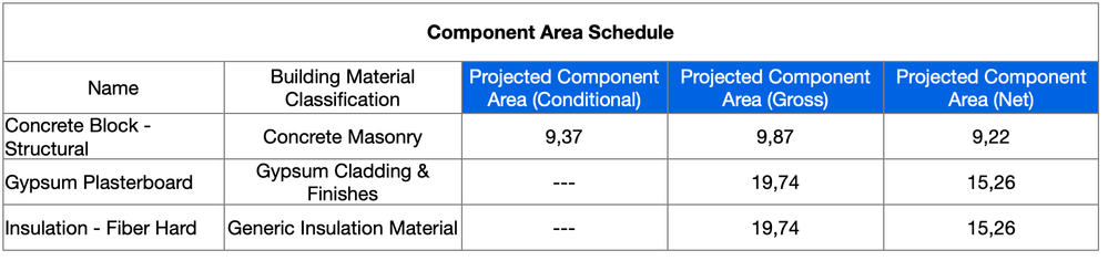

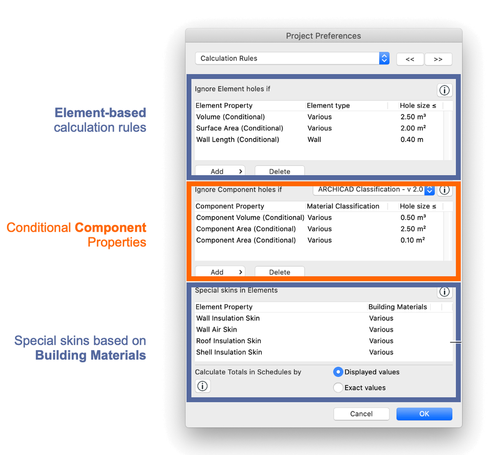

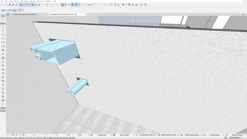

Archicad 25 introduces new properties for more accurate component Lists. You could schedule only the net value of component areas and component volumes in earlier versions: the holes were always subtracted. As of AC25, new "gross" and "conditional" area and volume properties are available to schedule component quantities.
With the new ‘gross’ and ‘conditional’ area and volume properties, it is possible to get more accurate building materials schedules and cost estimations. Furthermore, the user-defined and configurable conditions simplify the process to list components based on their Material-contingent function.
