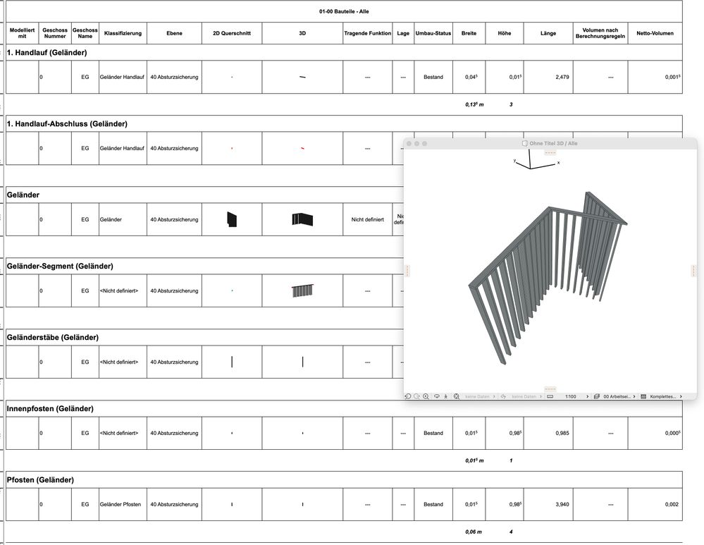

Ole
I can see (tiny) previews here on AC25. See screenshot.

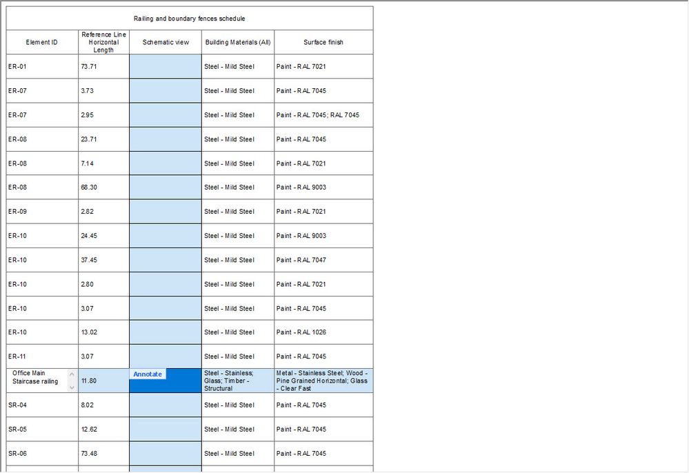

Ole, that would be OK...
Nothing here at all... curious... 6000 INT Full

Sorry, forgot: 25.0.0 v1 GER (6000)

so, "only" difference is INT and GER... ahem... 😄

For me, 3D Axonometry and Floor Plan Preview generates a preview while all 3D left/right/front/back do not.
I am wondering whether that is because a Railing can be in any position and rotation in Plan and can have many segments so left/right/front/back are not relevant. Maybe this is why there is no preview for these.

I checked with a new file, and all is as it should be. So it must be an issue with this file, or these particular types of the railings.
