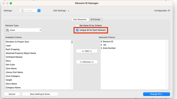

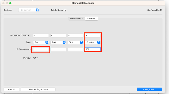

Use the Element ID Manager (under Document) to assign unique element IDs to multiple zones (with a counter)

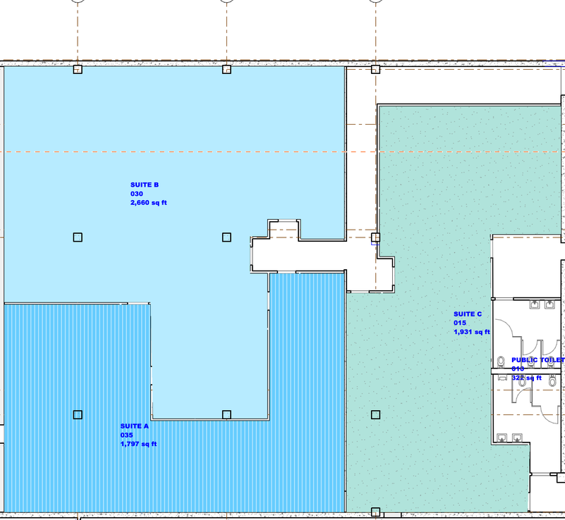

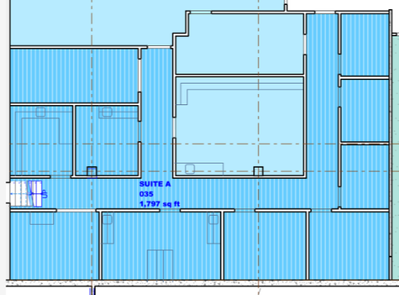

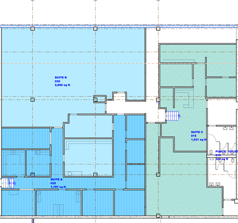

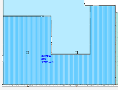

I've attached a sample of the approach I posted.  The zones shown here are large zones that cover the entirety of the unit (here shown with suite numbers), thereby describing the gross square feet.  These zones are positioned on their own layer and physically under the room zones (1" high and -1" under story), allowing for separate scheduling.
Depending on the need, they can be viewed in front or in back of the walls as shown in these two views.

The problem I have with this kind of approach is that the total area of the apartment is different that the sum area of each room area. Take for instance the suite A in your example, the total area include internal partitions and columns. The way I need to do it have to be excluding these elements.
