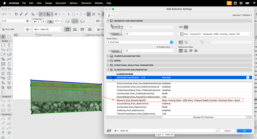

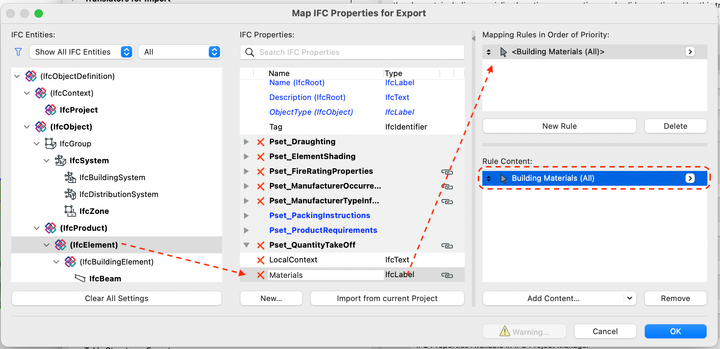

Hi David, the "Building Materials (ALL)" general parameter is not available directly in properties.
But it is available in the IFC Property Mapping for the translators, so you can create a mapping rule for each element, see below:

Thanks, Jaime!
I totally forgot that workaround... even having spent hundreds of hours in the past mapping properties using the translators.
I hope a more robust harmonization and automation is implemented in the future.
