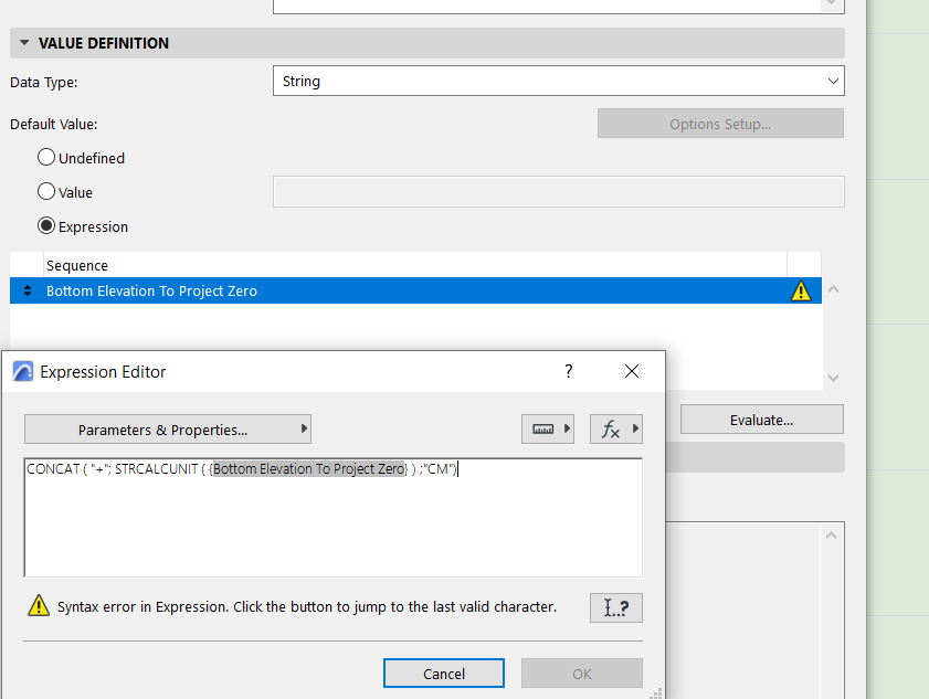

I have created an expression for the zone stamp to show the elevation, but it misses two things:
1. I try to add a + sign in front of the number to show it is upper than zero (and it is not showing on the stamp)
2. I try to add to show CM at the end of the number but it says syntax error.
How can i show these two on the zone stamp?
Thanks

David Lukacs
Hi Qingdom,
Try like this with string data type: CONCAT ( "+"; STRCALCUNIT ( {Property} ) ;"CM")

David Lukacs
Did you change the data type and did you paste the property (bottom elevation to project zero)?

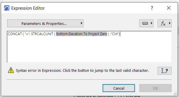

qingdom
Yes, see picture
AC27 INT | WIN10
David Lukacs
You have to remove the brackets { }.
qingdom
Still no succes 😄

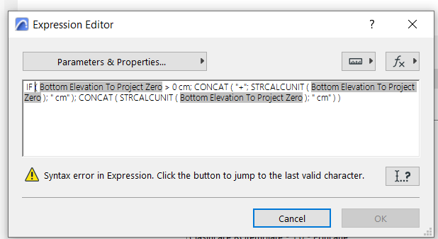

Yves
I will do like this
"Sorry in french"
IF ( {Property:Paramètres généraux/Altitude inférieure à Zéro du projet} > 0 cm; CONCAT ( "+"; STRCALCUNIT ( {Property:Paramètres généraux/Altitude inférieure à Zéro du projet} ); " cm" ); CONCAT ( STRCALCUNIT ( {Property:Paramètres généraux/Altitude inférieure à Zéro du projet} ); " cm" ) )

Yves
You are in String data type !
