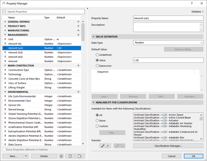

I will be happy to get some help.. first time I'm writing here…
trying to make a combined schedule with different elements, that will give me also the following information BY TWO COLUMNS.
I tried to make it by using the Property Manager with “option set” and “expressions” but couldn’t manage to do it.
FOR EXAMPLE:
| unit of measure | quantity |
AREA m2               | 5             (it will count the area of the wall/slab)
Nb of units            | 6            (it will count the nb of Elements/Objects)
LENGTH                 | 3.5        (it will count the length of the wall)
If I choose SPECIFIC “UNIT OF MEASURE” (by using “option set”) it will know to take the information from the Area/length/units PROPERTY. And show the correct Number. in the quantity column.
Thanks!

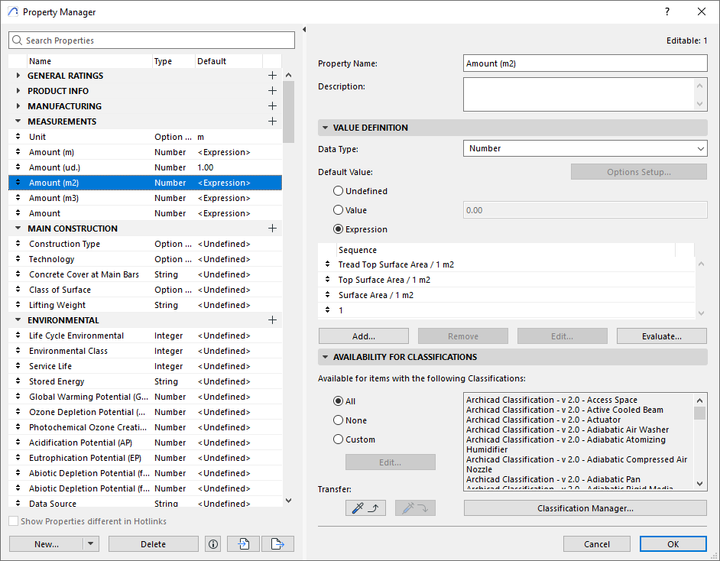

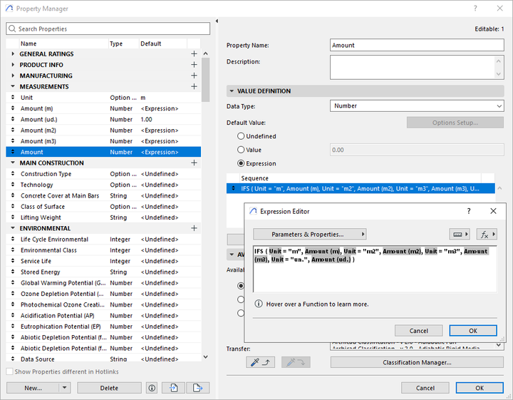

Pedro Melo
Is this what you are looking for?
