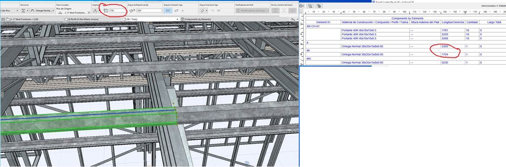

I am trying to generate a list of pieces of beams and columns, the problem is generated when joining two pieces of the same type, which in the drawing the rope or blue line is until the end of the section as seen in the image, but in the The list discounts that overlap, which is 38mm, so all the profiles with overlap discount those 38 mm. I have tried everything but nothing works for me. This list is to be entered into a profile cutting machine.
If you could help me please, most likely I must add some type of additional command to the scheme, I tried roundup and all its alternatives but it adds it to the entire profile so it doesn't work.
thank you

You could use expressions to add the missing information.
The logic might be to create:
  • "overlap" property where you write the overlap amount if it varies
  • Total property which is the sum of the Overlap + Existing length (Longitud Derecha in your schedule)
