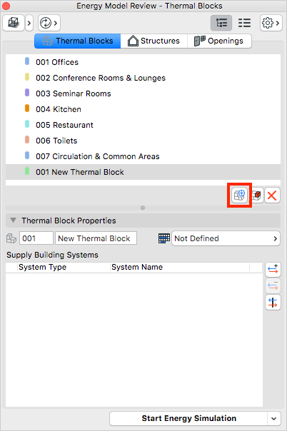

1. Go to Design > Energy Evaluation > Energy Model Review to open the Energy Model Review palette.
2. In the Thermal Blocks tab, create your thermal blocks by clicking the Add new Thermal Block button.
3. Give the Thermal Block a distinct ID and name.
4. Assign the Zones to the Thermal Blocks by clicking on the Add Zone to selected Thermal Block button.

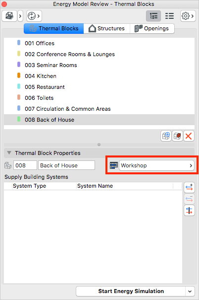

5. Choose an Operation Profile for each Thermal Block.

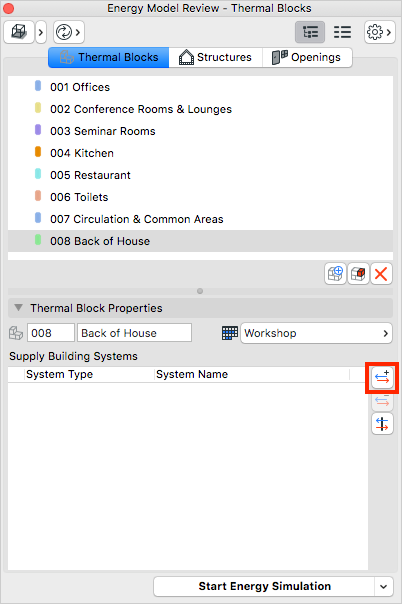

6. Click the Add new Building System button to open the Add Building System Palette.
7. In the Add Building System palette, select the building system(s) that correspond to the thermal block and click OK.

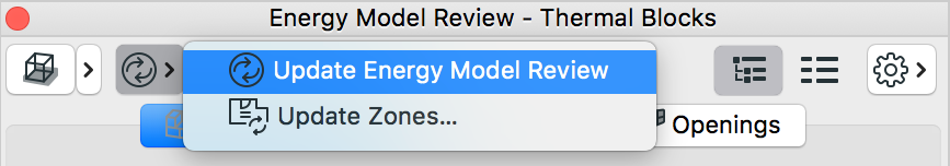

Later on, as your project evolves, you might need to add new Thermal Blocks, or remove one of them and rearrange the zones in the Thermal Blocks. You can adjust the number and arrangement of the Thermal Blocks at any time. You just have to update the energy model each time by using the Update Energy Model Review command on the Energy Model Review palette.
