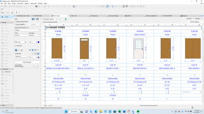

Archidad 20, door schedule is not interactive. I have to go to the plan to change click door and then open that door. One door will not even change thru clicking door on plan. Now 1 door has disappeared on plan but is still in schedule. Now when I tried to add the door it created 3 doors on the schedule. See mo8 and mo3 on schedule. Schedule and floor plan enclosed. What am I doing wrong/?

I checked and the subject doors are not on a different renovation filter. I have found that if I click on the door image in the schedule the word annotate displays. if I click on annotate that I can edit the dimensions in the image. This helped with a few stubborn doors. Now I have 3 doors that will not delete and are not on the plan. I tried the 2d and 3d methods of selecting. Now I have tried to exclude them from the schedule by labeling them NIS and excluding them from the door schedule. Does anyone have any suggestions? Label and exclude screenshot included.

Based on what I see in the generated schedule I think your Schedule Criteria is wrong:
It says:
"Library Part Name" is not "NIS"
It should say:
"Full Element ID" is not "NIS"
This is why those Doors still appear in the Schedule because they are not filtered out by the criteria.
