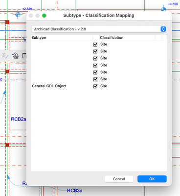

With the one of the updates in V28 this issue was solved but

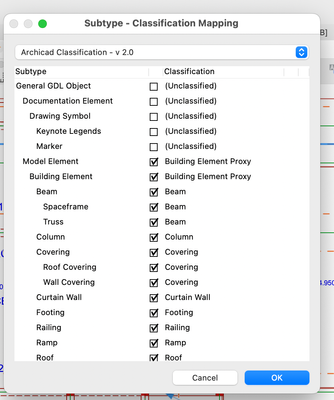

I found that even in V29, it crashes. I also found that the the default files are not crashing. only the old files.
I also found that it has someting to do with classification.  ( its not how ever crashing with V28)
Saw that classification is missing in the old file. I found this help page to restore
https://support.graphisoft.com/hc/en-us/articles/37623320822801-Why-does-Object-Library-show-unclass...
Did everything but..Subtype classification is not showing what default file is showing!   Earler before resotring the classification file, when i click the tool box menu 'sub type classification mapping'  Archicad was crashing instantly. This stopped when i restored the classificaiton file. It still crashes when i edit window schedule.
while importing V28 file to V29, this is lost! I was supposed to see this i believe
Can someone help to fix this? not sure if i fix, this will be resolved. I am still using 28 because of this crash.
