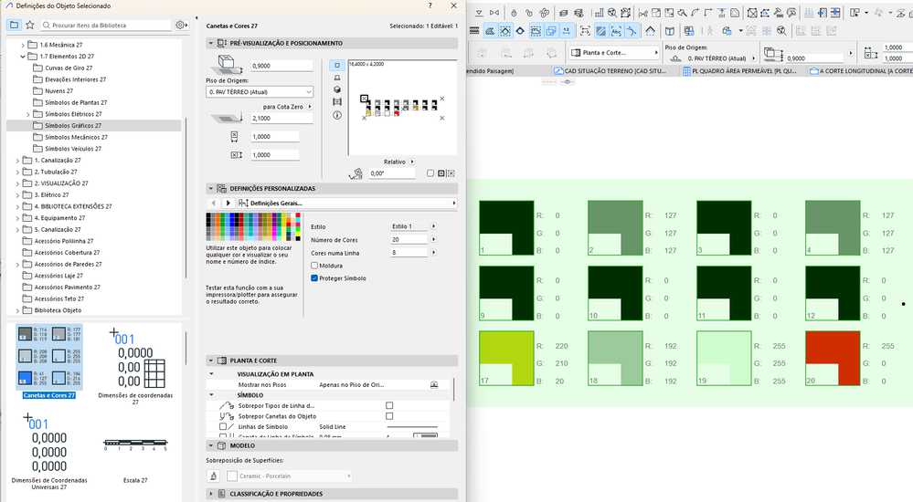

Hello
There is a object in Archicad library that you can use to show some pens and their rgb value, but it starting showing from pen 1, to 2, 3.... Very limeted object but it may help you save time
