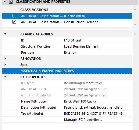

I'm trying to move AC20 properties into AC21. I have tried as follows:
1. Open an AC20 file in AC21. All the elements translate into 21 fine, but the properties are tied to 20 and will not read as 21 properties. So or instance if I create a new stair using 21, because that's a new element type, it will not show in the 20 properties listing
2. If I untick the 20 properties box and tick 21 instead, using the classification manager, all the 20 properties are lost
3. If I merge a 20 file into 21 it makes no difference, the same happens
4. If I create an xml file of my 20 properties, 21 will not read it so I can't transfer the properties that way
5. If I copy/paste a wall from 20 into 21, the IFC setting in the 21 classification defaults to "construction element"
6. I also notice that if you start to draw a default wall in 21, the property defaults are fine, but if you choose one of the UK favourites, they are not set up with the correct properties
My conclusion so far is that I will need to remake the whole of my favourites library in 21 from scratch!
That's a lot of wasted work.
By the way, the reason this is so important to me is that my favourites in 20 include all my specification data as well as a whole set of composites and complex profiles built up over time.

Nathan, thanks for taking the time to look at this.
I downloaded your files, however they are shown as 20 files, not 21 and the classification is still 20.
I have done some more experimenting and come up with what might be an answer to the properties problem, but not the IFC issue.
If I open a wall favourite in 21 imported from 20, I get 2 classification systems showing - 20 and 21.
If I delete the 20 classification system, all my 20 properties disappear. Not good!
However if I add anything from the 21 classification system to the wall element and then delete the 20 classification, all my 20 properties are retained. Good!
However that does mean I need to edit all my favourites to add a 21 classification. I guess that's not so bad
However the IFC type defaults to building element proxy, losing the 20 IFC tag

I have worked out how to get the xml file import to work.
If I open my 20 favourites file in 21, I can export from 21 as an xml file.
I then rename the old 20 properties tab as "old", then import the 21 xml and it comes in with all the property headings
I can then export the field data for both versions into an xls file and batch copy all the field data cross and re-import it
I can the delete the 20 classification and, leaving all the property data in the 21 classification.
The new stair and railing tools then read into the correct classifications.
