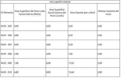

Hi everyone,
I’m new to Archicad and I can’t find a simple and correct way to get, in a wall schedule, the total external wall surface of the building in square meters.
My goal is to create a schedule that tells me how many external surfaces will need to be painted.
I have already tried several schedule fields (such as Wall Surface Area, External Face Surface Area Gross/Net), but the values I get don’t match:
• even in simple models (e.g. a 4×4 m room with a height of 2.70 m) the calculated surfaces don’t correspond to the expected mathematical value;
• in some cases the external surfaces are smaller, because Archicad subtracts the wall thickness at the intersections of corner walls;
Question:
👉 What is the correct method to make Archicad calculate the net external wall surface, with openings subtracted and internal parts excluded, so that the schedule gives me the real value of the surfaces to be painted?
Should I set up Zones, use a particular property, or is there a specific schedule field I am missing?
Sorry if this sounds like a basic question, but since I’m new to Archicad I can’t figure it out and it’s driving me crazy.

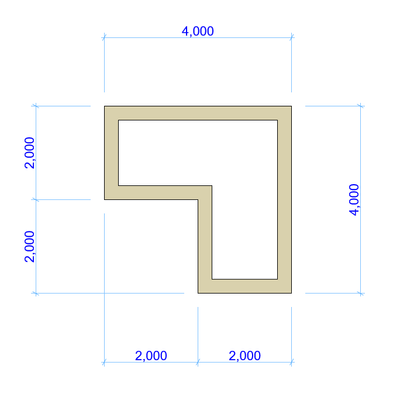

For clarity, I’m also attaching a simplified model (not my actual project, which is larger): I’m using it just for testing and to manually check the surface calculations.

you have to use the surface schedule in order to know the exact area of a surface.
If you try with the element schedule you can get the value "surface area on ouside face" or "inside face" but this value does not take into account penetrations due to PBM and SEOs ...

I have already tried with an abacus created for surfaces but I get wrong values, for example for a simple room I get different values ​​(including or not the thickness of the wall in the intersection areas) depending on the fields and I don't understand what I have to do to get the right result (I attach an image). I apologize again if my request seems triviale, and thank you

No need to be driven crazy just yet 😆@JaredBanks who is an Archimaster of residential design shows an accurate method using zones & schedules to extract accurate wall surface quantities.
I like his method very much and it is simple and easy to follow. He tests it, to show us how when a door is removed from the model and you update the schedule the quantity adjusts correctly.
Please see his method on his excellent tutorial video below.
https://www.youtube.com/watch?v=tWyUnDTBtG4

Yes he has zones set up for external areas from what I saw on the video. You can private message him to ask for more information on how he extracts that external painting area from the model.

This other video I did should cover exactly what you want: wall surface area.
https://youtu.be/_OcTE242CfU?si=ZHqVmKHQZt7k26KL
In the video I do tests with fills and different scheduled fields to confirm I have the right information.

I've already seen this video, but I need to take a closer look. In my case, if I use the same fields and verify their accuracy, even just to test on a simple shape, I get incorrect results for one reason or another (the surface area totals take into account the wall thicknesses on some walls and not others; if the wall is recessed, the entire calculation is calculated, not just the portion remaining outside, etc.). I'll try to take a closer look anyway.
