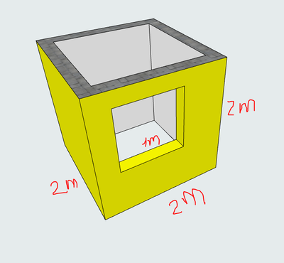

Hello,
you have to use the surface schedule in order to know the exact area of a surface.
If you try with the element schedule you can get the value "surface area on ouside face" or "inside face" but this value does not take into account penetrations due to PBM and SEOs ...
Here's a sketch. 4 walls; 2m long, 2m high and one opening 1 m x 1 m; wall thickness 20cm. Expected yellow surface 4x4 - 1 + 4x1x0,20 = 15.80
Then you can setup a schedule of surface (not of elements; in archicad there are 3 types of schedules) and you get the correct surface area, filtering by surface name

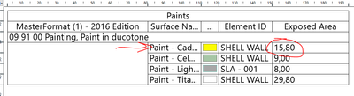

4 weeks ago
I have already tried with an abacus created for surfaces but I get wrong values, for example for a simple room I get different values (including or not the thickness of the wall in the intersection areas) depending on the fields and I don't understand what I have to do to get the right result (I attach an image). I apologize again if my request seems triviale, and thank you

Thanks for the reply.
I've already seen this video, but I need to take a closer look. In my case, if I use the same fields and verify their accuracy, even just to test on a simple shape, I get incorrect results for one reason or another (the surface area totals take into account the wall thicknesses on some walls and not others; if the wall is recessed, the entire calculation is calculated, not just the portion remaining outside, etc.). I'll try to take a closer look anyway.
