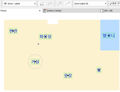

LeeJaeYoung
There are more than 2 layers in the zone label. (My mistake)
So I pressed the label and selected only the Zone label with ctrl+A.
Layers do not change.
A few still remain.
AC27 on window 11
I am not sure what you are doing then.
Zone labels, dimension labels, autotext, labels, etc., they are all just labels and all will select when you activate the label tool and press CTRL+A.
Change the layer and all of the labels should go to that layer.
I don't know why some labels would not change, unless they are locked themselves or maybe they are in a locked layer.

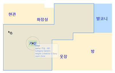

LeeJaeYoung
Only the label layer inside the circle is Annotation - Label.
The rest is zone-label.
Only label was selected.
How can I change the layer here?
AC27 on window 11

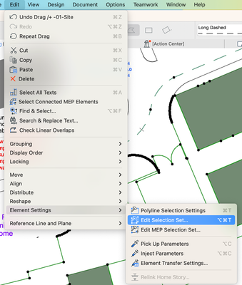

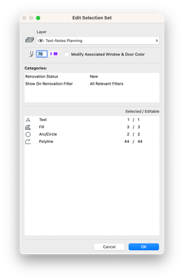

Lee Hankins
You can use Edit Selection set for this I believe. If you have multiple elements selected based on different tools, so you have labels, text and walls selected and want to move them all on to the same layer go to the 'Edit' menu then 'Element Settings' then 'Edit Selection Set...'
A new window will open that lists all of the types of items you have selected and how many are editable and you can change the Layer, Renovation Status and Pen of all of the elements altogether at the same time.
Lee Hankins
ArchiCAD 4.5 - Archicad 29
