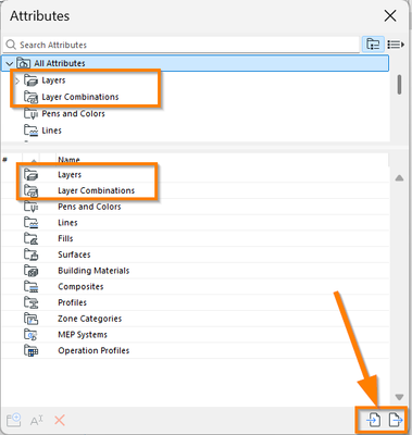

You can import/ export layers as a .XML file from Options> Element Attributes> Attributes as seen on the picture and try to follow the tedious steps from this old post: Layer / Layer Combination matrix spreadsheet
