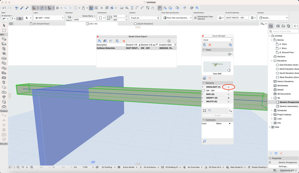

I'm trying to use ARCHICAD as a Coordination Tool, but I found a quite big limitation of AC27:
MEP Elements cannot be highlighted in the Issue Manager!
I even tried with the last preview update, but nothing unfortunately...
this is quite crucial for BIM collaboration!
Many thanks!

Yeah, still broken in AC 27.2 ....
Shame!
