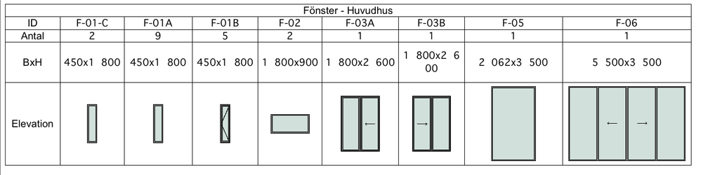

Is there a way to configure what order elements are shown in schedules? For some reason, my window schedule has gotten mixed up so that they are not shown in alphabetical order. Can I manually move a column some how?
See screenshot. I want the order to be the following:
F-01A
F-01B
F-01C
One way would of course be to change the labels, so F-01C becomes F-01A etc, but that wouldn't be logical for the project.

They are in order.
You have a dash in front of the C so that is why it is listing before A.

They are in order.
DangCad1
Haha, I didn't notice that. Thank you!
