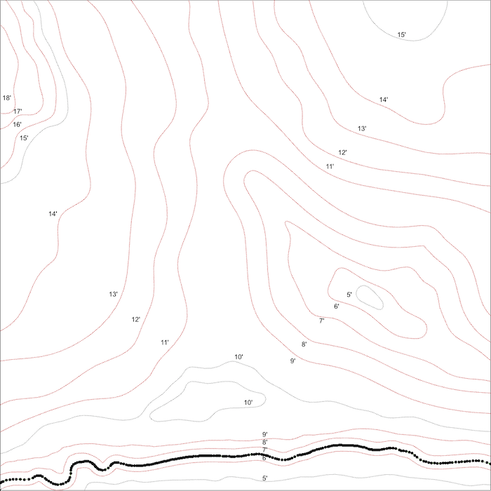

Surveyors data and DWGs from civil engineers tend be very detailed and contain numerous data points. This complexity, while necessary for their drawings, is usually not needed in the building model. Follow the steps below to create a simplified mesh from it from a detailed DWG.

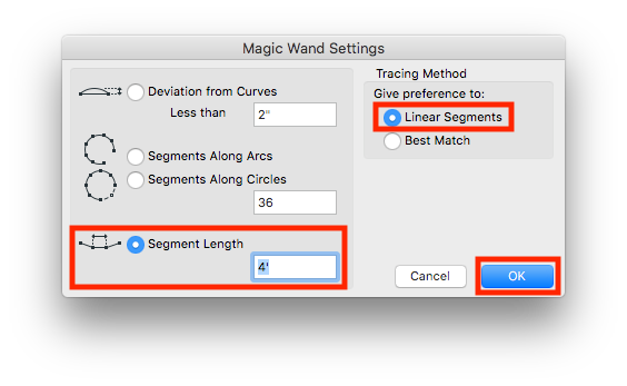

1. Go to Design > Magic Wand Settings...
2. In the Magic Wand Settings dialogue box set the Tracing Method to Linear Segments, increase the Segment Length to as large a value as possible and click OK.

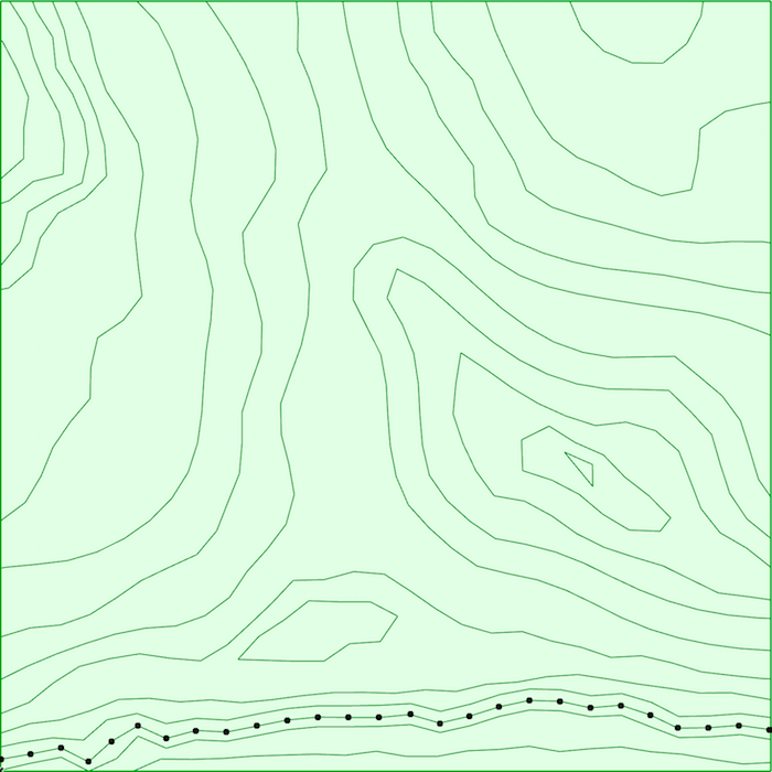

3. Add the ridges to the mesh using the Magic Wand Tool. (See the exact steps here.)
The result is a mesh with ridges that follow the original contours of the surveyors drawing but contain far fewer data points.

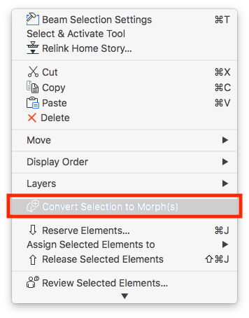

2. Select the meshes involved in Solid Element Operations.

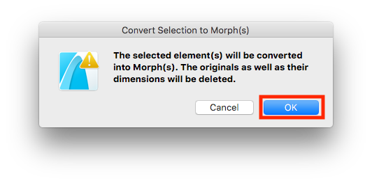

3. Right click and select Convert Selection to Morph(s).
4. In the Convert Selection to Morph(s) dialogue box, click OK.
NOTE: This will delete the original mesh. This is why you want to create an archive of it.
