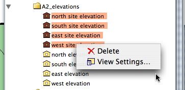

I have all my views set to manual rebuild. Is there any way I can rebuld all model s/e from model but using the view settings(especially layer combinations) instead of the model settings.

Thought that process was easy and obvious. too. However, the rest of the problem is that the command you noted above does not appear to use the view layer combo settings. Unless I have some other setting wrong.
It uses the settings that the current floor plan has. So bunches of things don't get rebuilt if the layer combos are different in the elevation view from the floor plan.
IMHO that is a major major problem. What that means is that I have to sit at the computer, open each view separately and rebuild it to get the right layer combo to display. Then update on the layouts. Am looking for something that will allow me to update all the views at once, automatically, to their saved layer combination.

as i said - in one of your topics talking about this - switch all of your manual-rebuild sect/elevs to 'automatic', open the drawing manager and select the placed views you want to update, and hit the update button.
switch the sect/elevs back to manual-rebuild once you've finished. you can use the 'selections' palette to help you manage the correct sect/elev selections to switch back.

Let me see if I understand the process. I have a bunch of views I want to update that are placed on the layout but the views have not been individually updated. So then I...
go to navigator
select the views I want to update
rebuild
have lunch while they rebuild
then select the views in the drawing manager, then hit update.
I have tried that, but the views update with the incorrect layer combinations. They update based on the layer combinations of the last open window.....unless I'm doing something way wrong.
