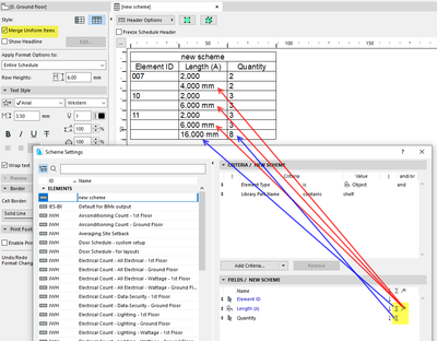

I just read through this again.
You only have two objects with a parameter that shows how many sub-objects they have.
I think because this is a parameter, the schedule won't recognise this field as something that needs to be added - no mater what numerical type you make that parameter.
If it is a unique (different) number it will display as 2 items even when set to merge uniform items.
If they are the same as in your image they should show as one item (6.56 | 20) but if you add a 'Quantity' field it will show 2 (so long as there are no other fields that make them 'unique').
All I can suggest is that you can show a total sum which will show 40 (the blue arrows in my image).
