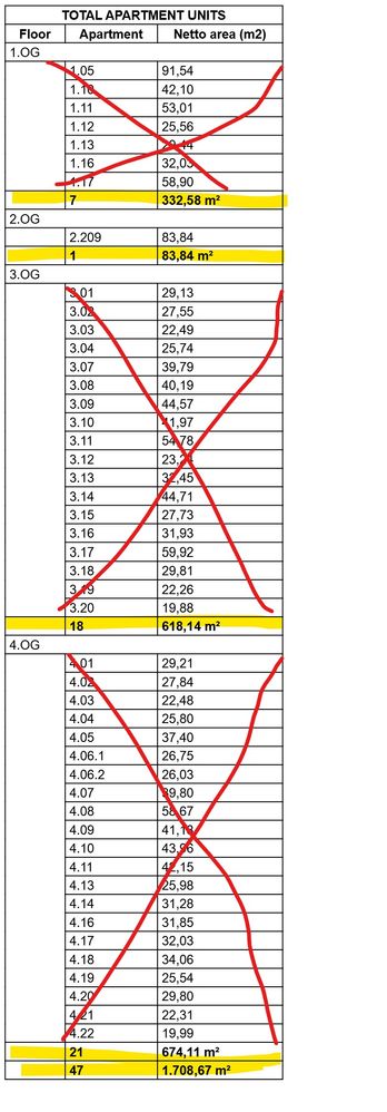

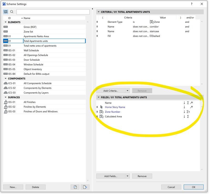

I need to do a schedule that display only total amounts, and not each value. For some reason I can´t understand, I can do it if one of the field is check with the ∑ sign, but once the sign is ∑1, the schedule display all the values. What am I missing?

Hi maurotrotta
Remove the zone number.
Each field you add works as a data differentiation factor.
As each zone number is different, the corresponding row is created.
If you only leave the floor field the information will be summarized.
You will have to add fields that contain identical data so that the rows are simplified.
Good Luck
