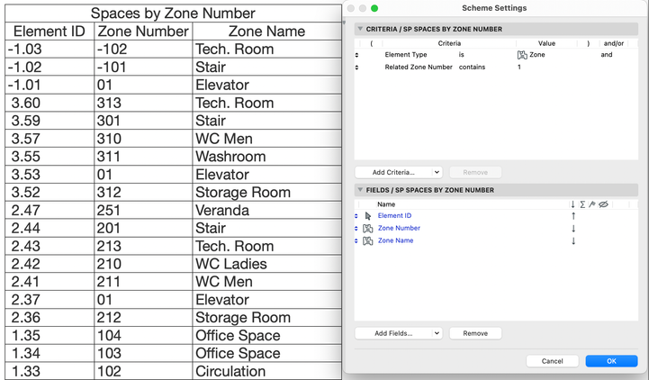

How to add the zone number to the criteria of a schedule?? I need to show only specific zones and the options I have are the related zone number or zone number 1 to 4, but none of them do what I need. I place a number to each of the zones, so I want to hace a schedule with the criteria of displaying specific zone that I will chose by their number.
I am using archicad 26. What am I missing??

The parameter you are looking for is "Related Zone Number"... see the example below, that shows only zones that contain the number "1" in the Zone Number.
