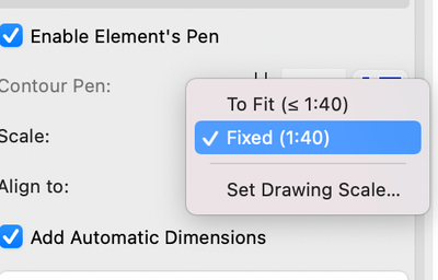

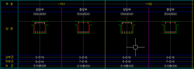

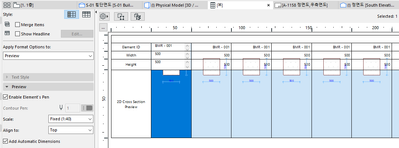

I would like to make it the top with a scale of 40.

Hi @LeeJaeYoung
Try changing the parameter on the left where the scale should change to 'To Fit' instead of 'Fixed', then a row with the 2D Cross Section Preview will be displayed properly:
Or try changing setting the dimensions of the schedule manually.
Hope this helps!

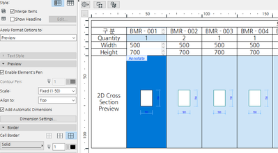

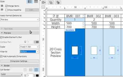

this is top ????
Bottom ???
I don't know top , bottom.
I think all is center.

Your elements all appear to be the same size, so whether you align by the top centre or bottom, you won't see a difference.
If you want to make the cell height smaller, you can drag the little black bar at the bottom left of the cell (in the margin).
Or double click it and it will automatically adjust to fit the contents of the cell - whether it be an image of just text.
