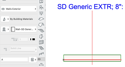

Has anyone had any success migrating older projects to AC25 and newer that use the label called Wall Type Indicator NCS20? Even if I manually load this label and its associated macros, the file's wall tags show up as missing.

Yes. What do you mean "the file's wall tags show up as missing."?

I see a big black dot. missing piece placeholder dot.

Does the Library Manager show it as missing?
Does it show up in the Label Settings > Type and Preview?

Yes to both questions David. I see a black dot, but I can select them and then assign the NCS label to them. This invariably results in rework as the labels have leader lines and has to be done floor by floor.
