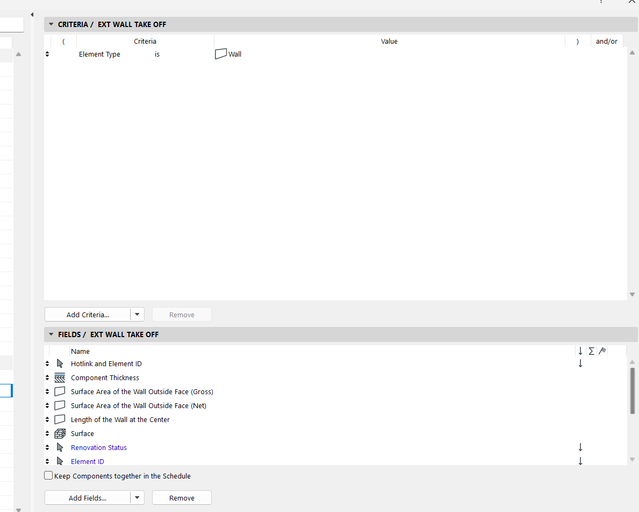

I'm trying to create a wall schedule, but it doesn't want to list any "new" walls even though I didn't restrict the schedule with renovation status, layers or anything else. The schedule lists "existing" and "to-be-demolished" walls but not "new".
When I change "existing" walls to "new" - they don't appear in the schedule.
I don't know where to look anymore. Does anyone know the solution to this problem?
I have the last update of Archicad.
Archicad 25

Hi @Kresho,
That’s happening due to you are activating Existing renovation filter.
you can change to show all elements to be able to see all walls in schedule.

Of course!
Thank you!
You’re welcome @Kresho
